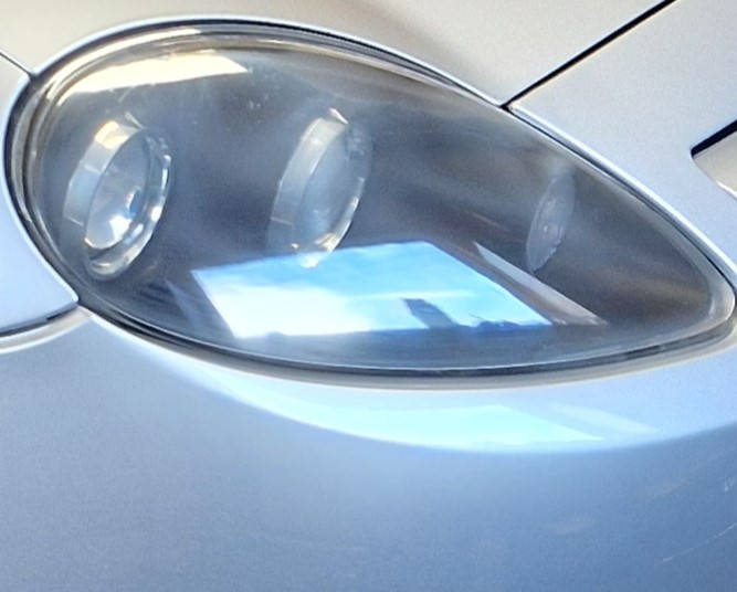

I'm not 100% convinced it is condensation. It's not like fine water bubbles it's milky grey mainly at the top edge. I have power next to where it is parked so I will try a hairdryer on it tomorrow and see how I get on.

Managed to blow up a pic of when it was in the garage. I can assure you the outer lens has been finely polished. The marks you see are inside the lens.

I have had the hairdryer on it this morning..the one I keep in my MX5 glovebox along with other products..and it is definitely condensation. I only had time to give it a short go because I was in my pyjama's and the neighbours were stirring.
It has a deep grey rim around the top and it's rather like swilling out a cup of coffee...most goes but you are left with a ring around the cup which needs physical abrasion. I think the lens needs the same.
