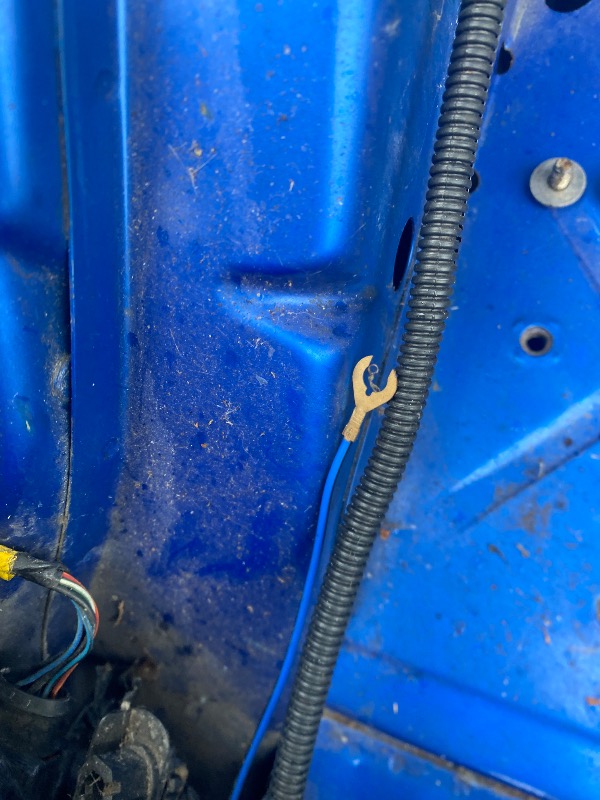

Also, what’s the best wire to add onto the end of the blue wire from the kit (it’s the under bonnet earth wire) as I’d like to run it up to the earth point that the horns use…
Black wire, since that is the earth point.
ok great - what electrical black wire do I look to purchase? Any particular core etc? I have no clue lol

You need black car wire - General Purpose Wire (GPT) of 1.0 sqare mm thicknes, in legth you choose.
by Roverlike

Posted 1 year 3 months ago #212573You need black car wire - General Purpose Wire (GPT) of 1.0 sqare mm thicknes, in legth you choose.
I can only seem to fine 1.5mm, is that ok if running off 1.00mm?
by Malakite
Replied by Roverlike on topic Adding Spotlights to MGTF - wiring help needed pretty please!
Posted 1 year 3 months ago #212574
You do not have problem if thicknes is greater, only it must not be smaller.
