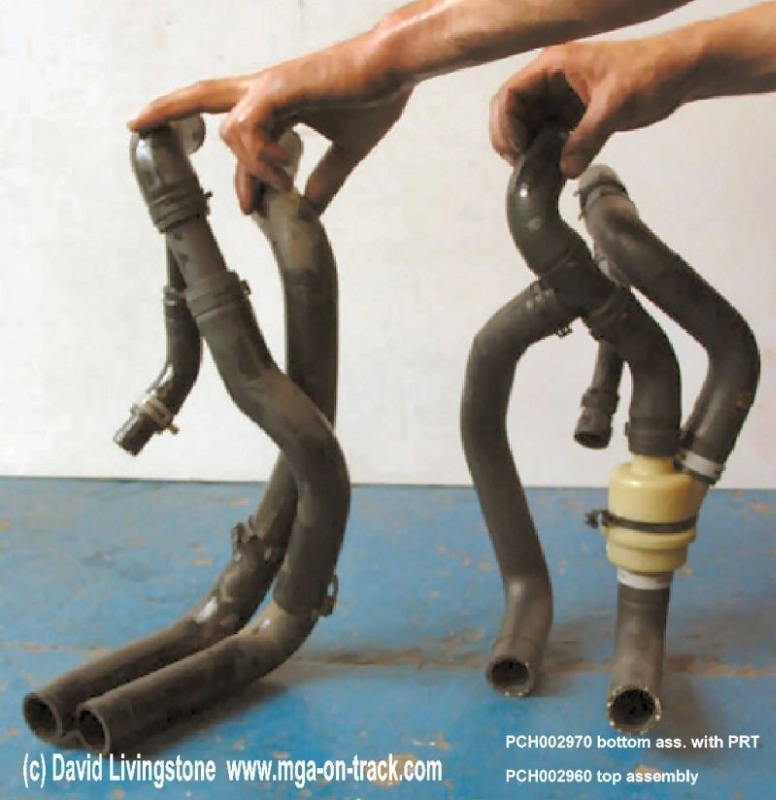

David Aiketgate replied:-
When my pipework was converted to accommodate the prt, my friendly professional  mechanic did it.
he referred to this photograph:-
and I recall him saying that he only needed a 't' piece and one small diameter piece of hose in addition to adapting the existing pipework to fit.
The work was completed from below without the need for engine out!
Don't forget to remove the original thermostat...

Replied by Delbourt on topic Heater hoses
Posted 1 year 7 months ago #210010
First up though. Does anyone know of a source for the flow restrictor that fits into the hose associated with the PRT system?
It apparently has a hole through it of 8mm bore.
i know you have to cut the “mechanism” from the existing thermostat (mounted at the engine), but in doing that the hole must be way larger than 8mm.
Now to answer various questions
Yes, those are the spring clips, and without good access difficult to get aligned properly.
Why convert. Well as said I have some doubt about hose condition, the existing hoses no longer have the heat shield, if renewing hoses it makes sense to convert to reduce potential for HGF (if the conversion by the factory was not beneficial why would they have done it).
Hose kits are more readily available for the PRT particularly in silicone.
The downside- leaving the hoses for the heater will forever be a weakness (but I’m not about to drop the engine to gain access).
