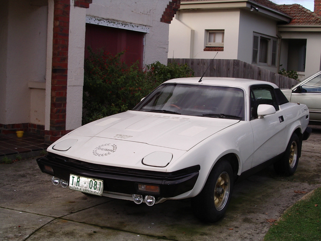

On my Triumph TR7 it had a little box of tricks made by Pektron, what it did was control the pop up headlights with a delay timer so the lights would momentarily stay up so as the lights could be flashed. It had shat itself so I got a geek mate to crack it open and he replaced all the crap soldered to the circuit board but the chip.....Sorted!
I ended up not using it anyway as I ended up discreetly fitting the car with both fog and driving lights, under the front bumper, it made more sense to use the driving lights for flashing purposes (saves the pop up mechanism for unnecessary ware and tear)
