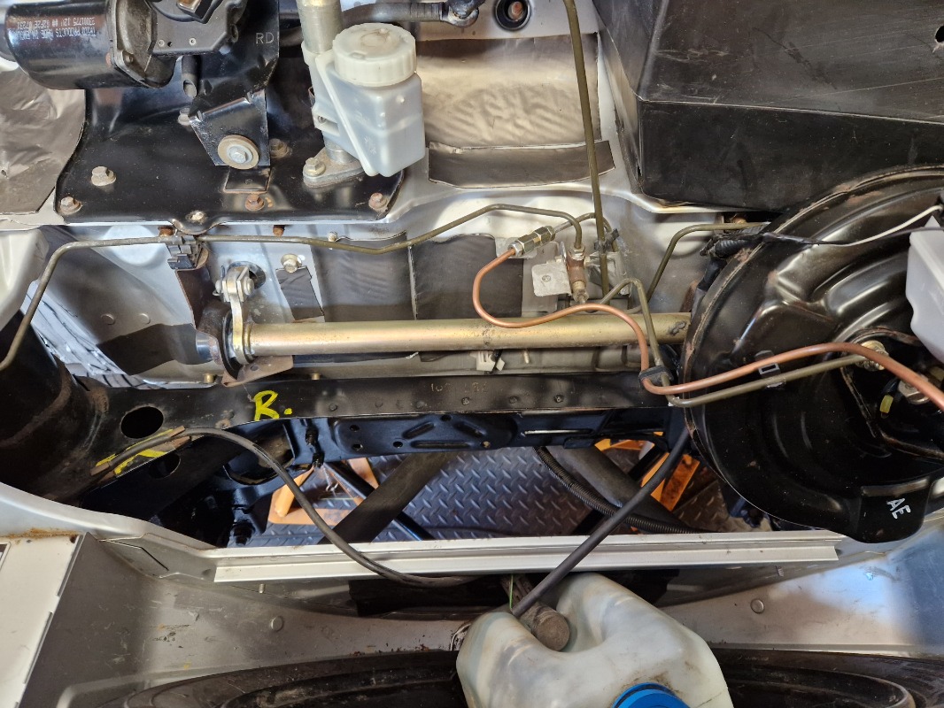

Removing the Proportioning valve gave more braking to the rear and felt much better as the car sat under braking. A nice feel. I could not make it lock the back brakes first no matter what road surface I was on so for my purposes I deem it safe.
Β
Β
In all honesty this transformed the braking performance dramatically and I was prepared to leave them be.

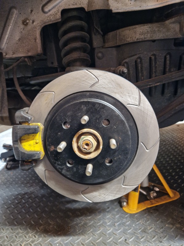

I bought the TTPerformance rear brake kit. TT had done it to improve rear brakes when the fronts were fitted with 304mm 4 pots.
Hence he did not do front kits. The kit looked superb and it really is.
I planned doing the fronts too so I fitted the rears with 280mm discs and the Yellowstuff pads.Β
I did do a short road test. I could feel more braking at the rear but it still would not lock up but I would NOT advise upgrading just the rear with 240mm fronts for obvious reasons!

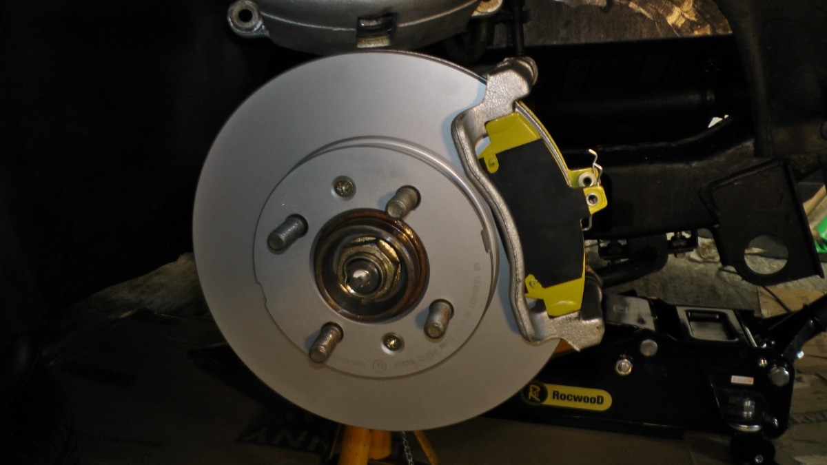

I got the front discs and calliper brackets from another supplier on Ebay.
The discs are of good quality and the brackets also fit. What may seem like a downer was two washers of different thicknesses to space the brackets so that the disc runs central. As it happens when you look at the original calliper frame and the brackets on the hub the mating face is only the size of the washer.
I used both washers to allow the discs to run central in the calipper and it was bang on. As far as mounting holes everything was perfect and the brackets are parallel to the discs.

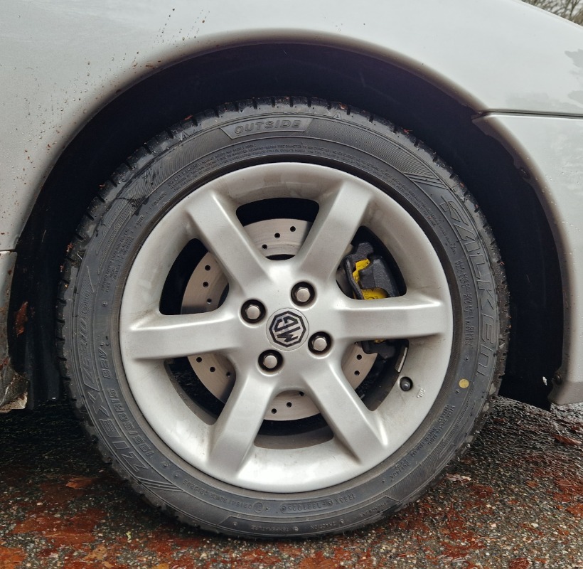

Having the Yellow pads already and then upgrading to bigger discs has finished my brake journey.
I road tested it today on some favourite mountain roads.
"How did it go Brian?"Β πππππ
"How are the brakes Brian?" πππππ
"Are you happy now Brian?"Β ππππππππππ

The rear wouldn't lock up even when I just fitted 280mm rears first but certainly not advised!
With 280mm all round the front still locks up first even on gravel.
Looking at the master cylinder the front take off gets a bigger stroke than the rears because the pressure is being sent to the front first so it is naturally front biased.
Removing the PV has probably given it a 60/40 split..guessing ..instead of 70/30..guessing.
