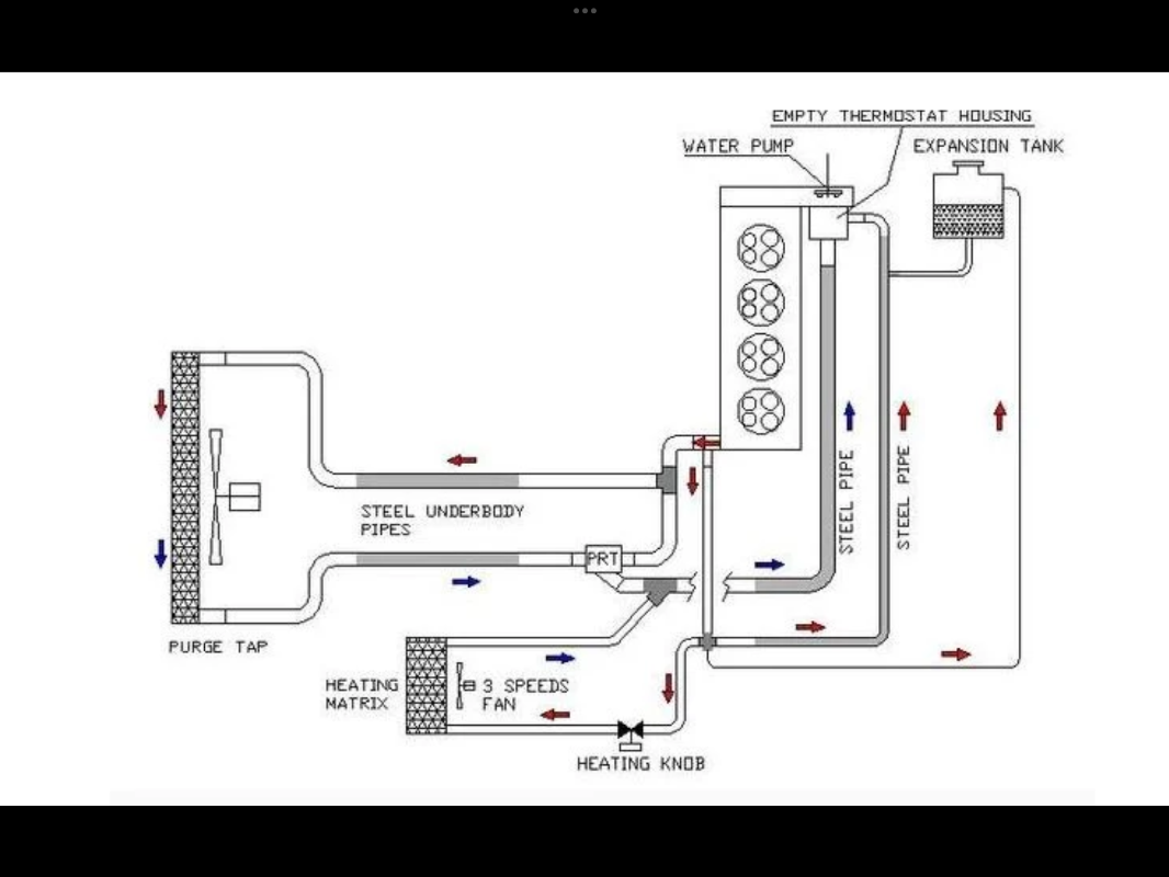

Many of you will have had cars “pre” and “post” PRT. I am trying to locate drawings indicating the differences in flow and the consequences of that to see if that helps to produce an explanation.
I think that the PRT stat has to open before any flow gets to the rad.
I think that the heater should get flow almost immediately but need to check this.
I thought that flow should come from the bleed screw on the water rail by the cylinder head almost immediately and if correct why is that not happening?
Why did the engine bay fan come on when nothing would come out of any of the three open vents (rad,heater,water rail). Water was circulating back into the header tank.

After viewing   courtesy of MG-Rover forum and trevtherevs/dert I am still puzzled as to why fluid is not being pumped out when the vent plugs are opened.
”We” know the rad was full when the plug was lost. It is understandable that water might not be being returned until the PRT opens but coolant should still flow out of that vent.
There is fluid in the rail by the cylinder head and definitely not restriction there but nothing gets pushed  out when the engine was running and water circulation into head tank was taking place.
Similarly the heater bleed point.
It is understandable that in closed vents that water might not circulate due to an air lock but any open vent must surely release water/air until all air is expelled.
Nothing will happen now until the replacement plug arrives other than re fitting the front valance after failing to retrieve the lost plug.
But any theory as to why no water is coming out of the vents will be well received.

If you were around when i was posting about the cooling system tribulations i had on a Mk1 F you will have seen I had not too dissimilar symptoms which defied my own fault finding and had begun to empty the well of ideas on this and the MGR forum. I flushed the system through multiple times with mains water pressure, replaced the thermostat, the water pump and the radiator with no change.
In the end I went back to first principles, looked at a diagram of the cooling system yet again and this time went to the hottest part of the system which is the outlet assembly at the front side of the engine. removing all of it's hoses I was surprised to see the metal spigot i had just removed a half inch hose from was solidly blocked with detritus. This had clearly built up over the years around the tempertaure sensors (being the narrowest flow point in the flow there) blocking the spigot and preventing the bypass flow. Now due to the slightly unusual cooling system configuration the thermostat relies on a working bypass flow to open. Clearing this blockage resolved the issue immediately.
