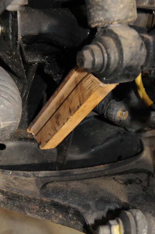

I have just replaced the Front Wheel Bearing on my TF.  I followed the instructions in the workshop manual, but that misses-out any instruction to remove the ABS Sensor from the hub!!

I searched this site for a "How-To" on the subject of front wheel bearing change, but there does not seem to be one.  Cj'sFront Upper Ball Joint replacement - How ToIs very helpful, but does not cover the problems I had with getting enough room to pull the stem of the upper joint out of the hole in the top suspension arm. so here are my ideas:

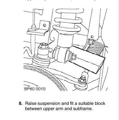

The workshop Manual shows this method of holding the upper arm high enough:
My attempts to use that location resulted in crushed wood and nowhere nearly enough clearance to remove the balljoint.

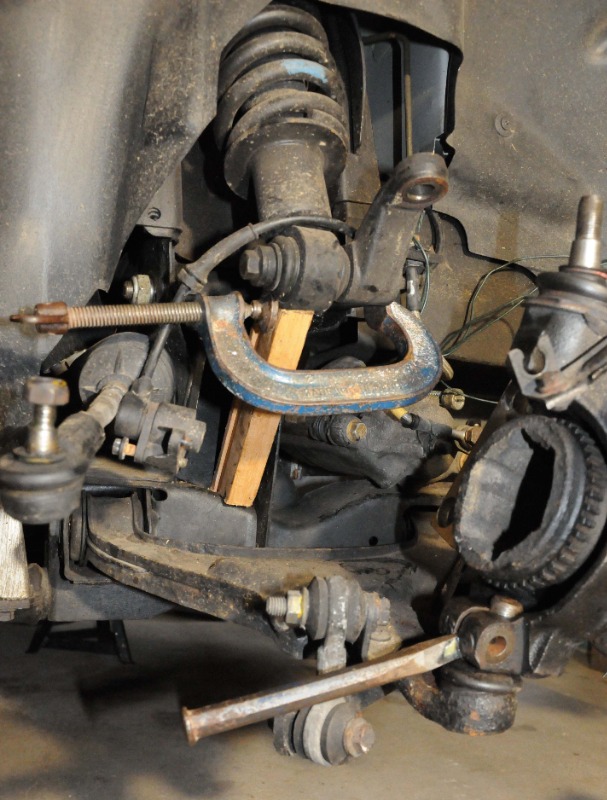

This DID work:
A clamp helped keep it in situ:

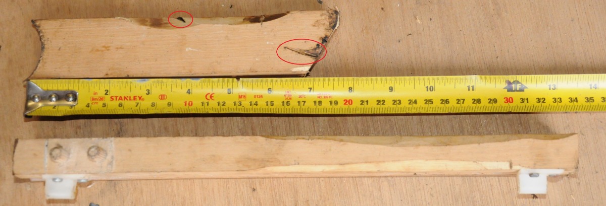

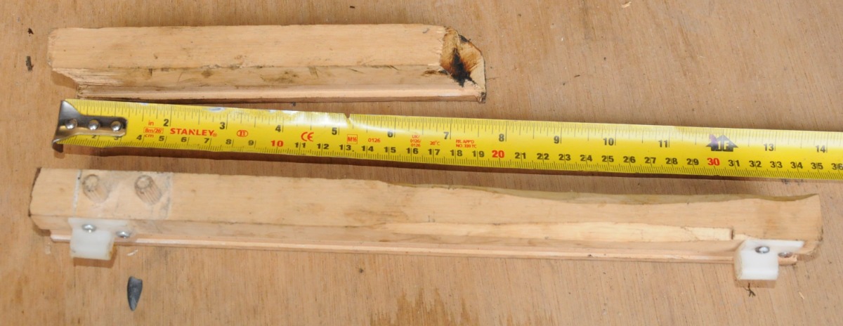

This shows shapes & sizes, the longer strut was used to jack-up the upper arm.
The scars highlighted in red are where the wood touches the suframe.  Removing wood in these areas helps keep the strut in-situ.  The strut shown is what I made and used on the right front. (Drivers side on a British, RHD car).  For the LHS, the cut-outs will need to be on the opposite face.
I found that the hardest job was lifting & separating the Hub from the lower suspension joint.  There was more rust on the pinch bolt than anywhere else on the whole suspension assembly.  I had to use a cold chisel (see bottom of photo).  I aligned that chisel as near vertical as possible and had to thump seven shades of sh*** out of it to move the hub up and off the lower balljoint.

Yes, both sides are conventional right-hand threads.  I see that there is only one part number: (RFG100090 for "with ABS" version)) for the TF front stub axles, which confirms that the threads must be identical.

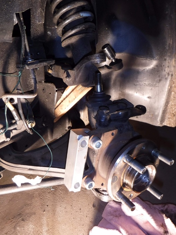

I did the LHS earlier today.  The only difficult job was, as on the RHS, the lower joint, which was just as rusty.  A liberal soaking with WD40 and the near vertical cold chisel helped.  I suspect that the design of this joint is to blame.  There is an open slot which water, mud and other corrosive road grime will enter and soak the pinch bolt + the hole it sits in.
My strut worked on the LHS with minor modification adding a cut out on the flank to make it ambidextrous.
As you can see from the photo, this strut gives plenty of headroom to allow the balljoint taper on the top balljoint to be removed and re-inserted after the bearings have been replaced.

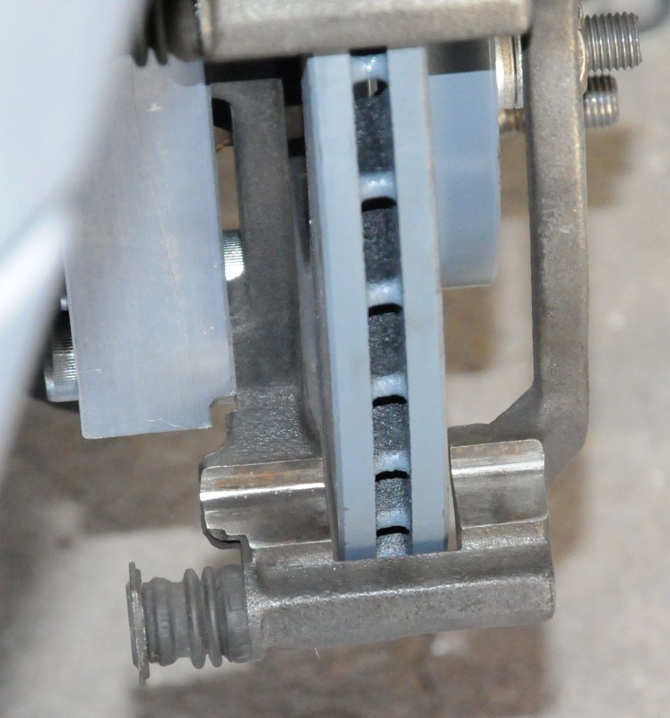

 I notice you have calliper spacers for bigger discs..280mm route?

Yes, 280mm discs in a kit I bought on Ebay from someone called William Naylor. If you contact him directly he could sell to you direct and avoid Ebay commission:  All the spelling mistakes are his, not mine!

W naylor I am attaching a Word document which you might find useful.  The braking effect is MUCH better than standard, my one reservation is that the adaptor places the calliper about 1mm too far out. As a result, the discs are contacted all the way out to the edge (no bad thing perhaps?) but a lip only 1mm or so wide develops on the outer edges of the pads.  PM me if you want more details, I took plenty of pictures.
