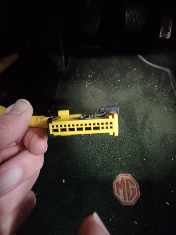

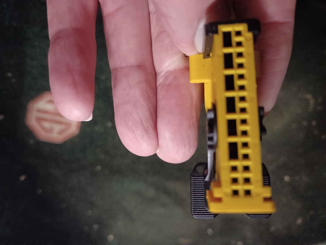

Can you post a picture of the connector where you get connection on both pins, showing pins?
Since in all cases you mention pins on connector block on DCU side are neighbouring ones, are you sure you are not touching two pins at same time with the probe?

You can put the probe into the two small square holes under the oblong hole and get the same reading without moving the probe at the airbag connector.
Also you can put the probe into the oblong hole above the two small holes and get the same reading.
The drivers airbag connector is the first oblong hole past the six small square holes.

If you get same reading in oblong hole below/above (depends how you look at the picture) two small holes which are for drivers airbag I suspect that probe went too deep and is actualy touching another pin/terminal within the connector.
In this case I would just discard this as irrelevant since it is not a way how to address your problem.

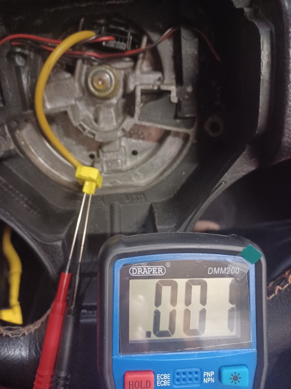

Hi, I'm back on the F, rechecked readings but with probes barely touching pins on the dcu multiplug and drivers airbag connector same result.
There isn't any corrosion on the dcu connectors or the multiplug connector.
The other airbag i tried was the same. I sourced it from mgfntfbitz so it should be good
The readings on the photo are with the dcu dis-connected and the probes either side the airbag connector I also did this test with the rotary coupling disconnected and got the same result. I saw this test online so think my coupling is ok.
I haven't done an airbag airbag test, not sure how to, I've read they can go off doing the test witn a multimeter.

You should not get that kind of reading on your multimeter. If probes were barely touching terminals, then you have some shorting on lines somewhere. In thins case even new DCU would not help. Wiring seems to be the problem. Rotary coupler usualy breaks the line, not make shorting.

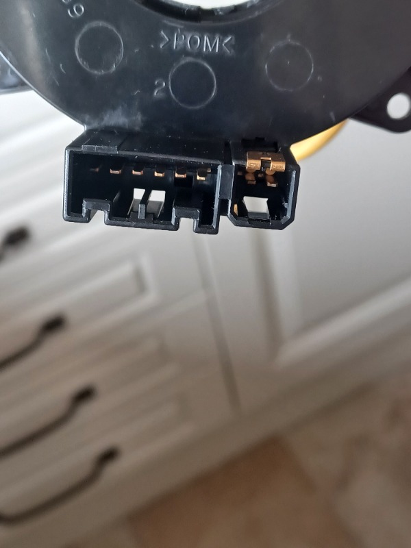

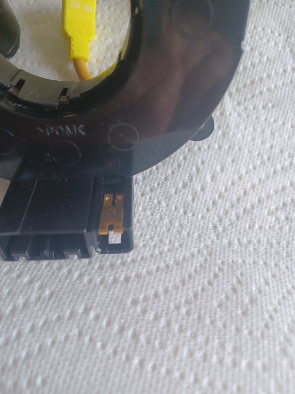

Hi Roverlike,
Thanks for the help, i just wanted to say when i first took the resistance readings it was with 2mm probes and they had to be pushed hard lnto the connectors to get a reading.
I then bought 1mm probes and this made it easier to take the readings, both sets of readings were the same.
So when i say barley touching, the probes are well into the connectors but not pushed through to far.
I have taken the coupler off the vehicle again and resistance seems ok.
I have taken a couple of photo's of the coupler, the pins are separate where the block connector fits on, but then the metal is folded over and it is joined together.
Like i said I'm no electrician but i don't understand this.
