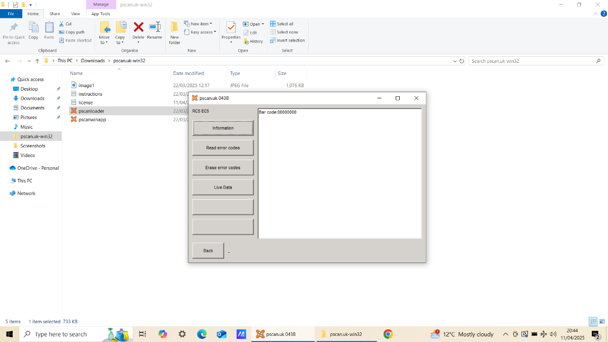

One question: do you still have posibility to connect PScan and inspect DCU you have on the car? If you can, can you make screenshot of what info you get when hit Information button under EC5/RC5 airbag ECU interrogation?

Not sure if the screenshot tells you anything.
The dcu was manufactured Nov 1994 and i go into the system using ec5/rc5
Both airbags autoliv.

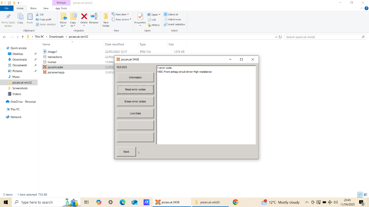

Some progress i fitted a dcu 103380 off ebay a couple of days ago and the srs light went out. I checked it a few times that evening and again the following morning all good.
I then bolted down the dcu and tightened the two bolts on the fuse box under the dashboard, then re-checked the srs and the light came back on.
The pscan gives the same error code C150 front airbag cicuit driver high resistance.
The light has been intermittent, i have had the fuse box back down and disconnected the yellow block connector and cleaned the terminals all seems well.
I'm not sure if I've got two faults or wether the dcu I've just bought has the same fault as the original.

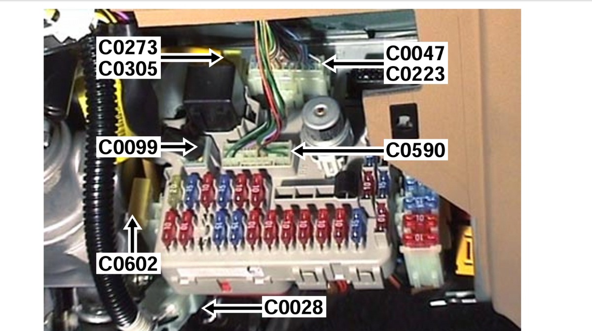

Since you said that error returned when you bolted DCU and fusebox I am investigating what could disturb the situation in that area. This is a long shot, but since three signals have interconnection in wires, although they are not related to drivers airbag, might be worth to recheck that connections. Signals that have interconnection are power to the DCU, OBD port signal and instrument pack lamp. They are passing through interconnections C0223-C0047 and C0273-C0305  on the below picture in the fuse box (shown below). Maybe worth to recheck that connectors and clean them.
