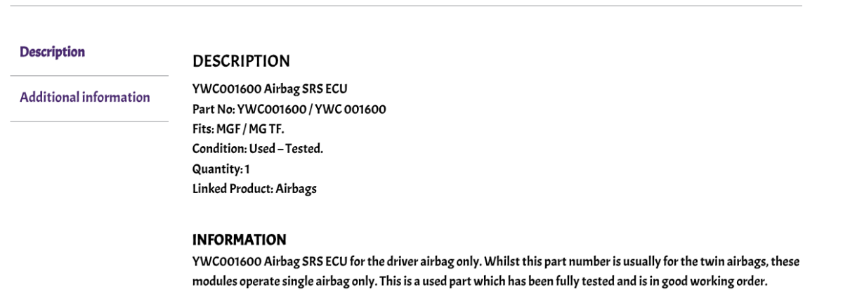

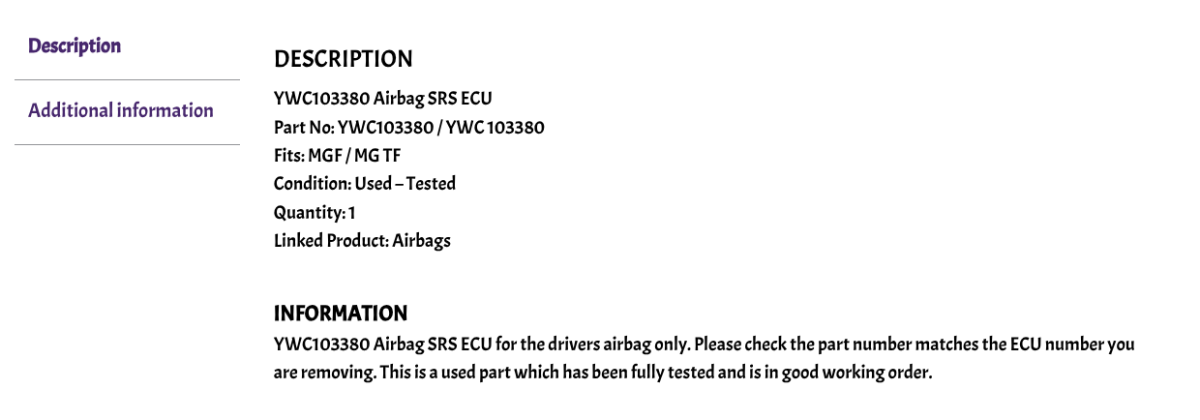

Hi Roverlike
I have just seen these on the mgfntf bitz site.m
Does this mean you can re-program the dcu if you need too, or have they got it wrong and there just not re-programmable.
Bit of a learning curve going on here.
Hope you can read the attachments.
It says 001600 is the number for dual airbag but this one is for drivers only. The other one 103380 is for drivers side only.
This could make buying used difficult, many don't say if single or dual and one i contacted didn't know.
Regards
Pete.

EC5/RC5 airbag ECUs are not programmable ones. They need to be set in factory with proper equipment. Later MG TFs had programmable AB Autoliv airbag ECUs.
What is written on shown pages from Mgfntf bitz is rather confusing and against what I know up to now. I do not know if they find a way to tweak these ECUs by themselves. On the pages they also say they are tested. Having in mind that Mgfntf bitz are really good sellers, I do not know what to say on their offerings.

The only information I have on dual ‘bags is 00160 & if there is strong money involved for a device without that number or the number qualified by Roverlike, I would walking away.
I hold Bitz in high regard as I have bought & visited on numerous occasions, having been please with the outcomes.
Whether they have hacked the single I wouldn’t like to say but I think it unlikely. Information like that would be “bush fire” stuff & although ‘Bitz reconditioned stuff is very impressive, the time & effort in cracking single too dual airbag modules for very obsolete cars is an investment of questionable merit.
