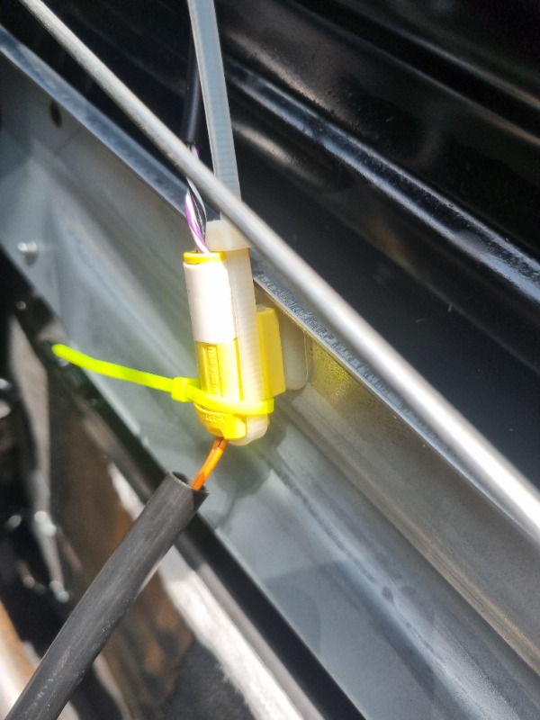

Maybe the cause is repaired.
O/S underseat connection is secure but the N/S removed itself as soon as I put my hand under the seat to find it.
The seat had to come out and the connector is now double tied as I think the latch has broken/worn/NIS.
The hood had to come back to reduce working temperature in the cabin so I cannot say it is fixed but the light extinguished on starting.
The rotary coupler replacement is on hold but not forogtten until the light is back on again. MOT in August and plenty of time to do that job at my leisure.
