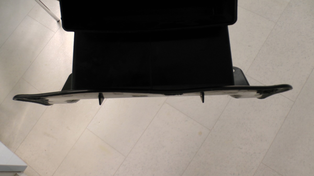

I'm currently experimenting with making a nitrile rubber gasket for the snorkel as the foam thing is "inadequate".
Mine is as bent as a 9 quid note.  No idea if that is normal.  Presumable caused by bolting down on a weak plastic structure.
As it happens the thick steel brace should flatten it out!

I made a 'brace' for the rear of the snorkel in order to keep it uniformly flat against the seal. [ a short length of aluminium carpet threshold strip did nicely]

I also made my made my own packer to go between the snorkel & bulkhead. It was about 10mm closed cell neoprene, self adhesive on one side & as with Chris, I made strengthening ribs.
A thin smear of silicon grease & there hasn’t been any suggestion of damp in the footwell.
Everything clamped up well

I also used neoprene, following AP´s advise, and it worked a treat

Notnumber - thanks for that reminder. I need to "brace the rear as well.  Strengthening ribs??
AP - 10mm neoprene seems a better choice than the nitrile, which has very little compressability .  Lucky I haven't cut it yet!
