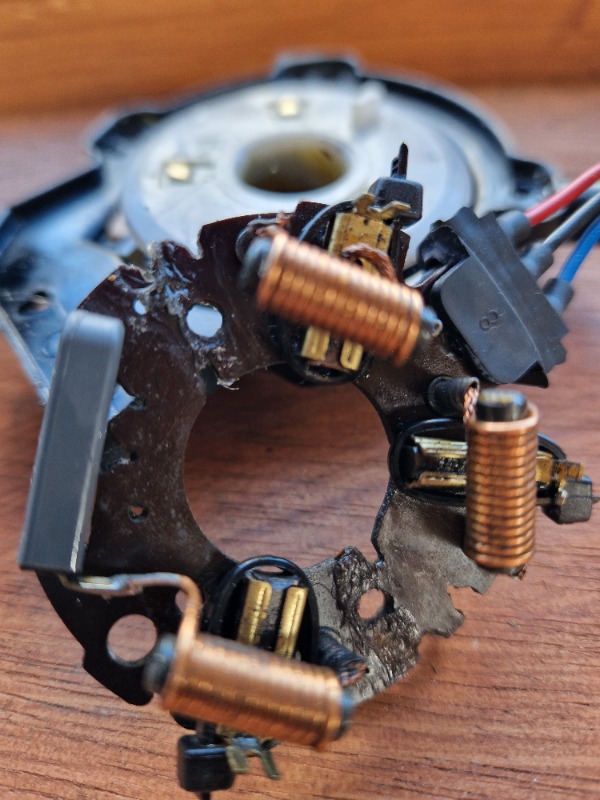

It's a very simple design and the hardest part is removing the disc with the electrics attached. It is quite delicate but it has to come off to get to the bearing.
I have tiny cable ties and I will tie the brushes back in to their housings against their springs so I can put the spindle back through the bearing.

Cable tied the brushes in place to be able to put the armature back in place when the time comes.

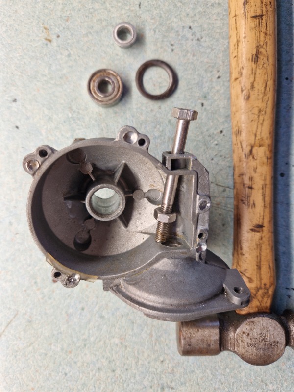

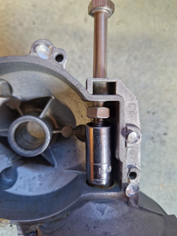

Drifted out the bearing using a 11mm quarter inch socket with the blunt end against the collet. I used a nut and bolt to centre the bolt and knocked it out with that.
It is very tight! In hindsight I should have heated the gearbox housing in the oven. At this stage there is nothing perishable to worry about.
The bearing and the "circlip" and the collet came out together. It's impossible to remove the circlip on its own.
I cleaned up the bearing but its impossible to read the number. Rimmers stock them.

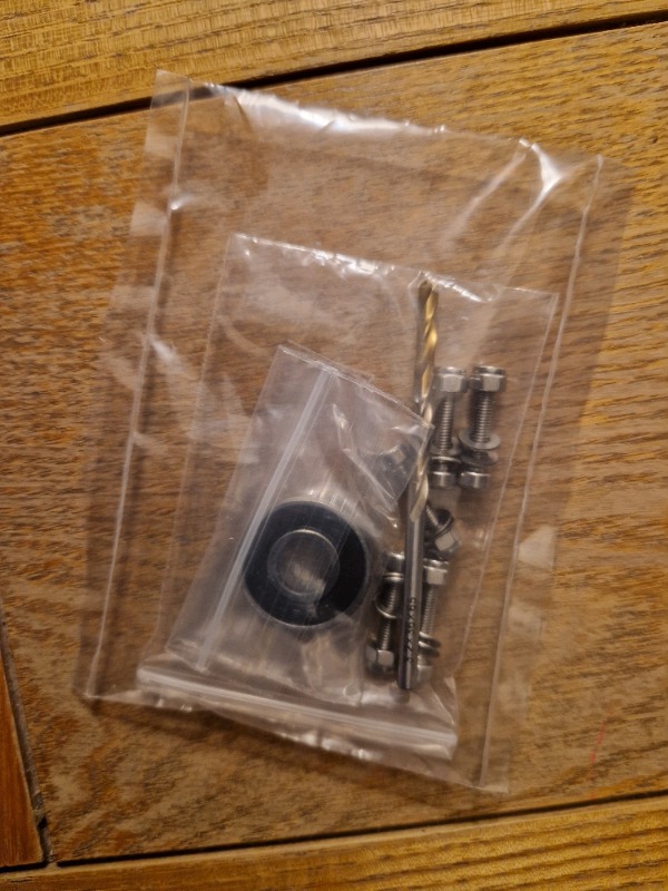

I found one on Wednesday evening from MGMania for a tenner. It's a better bearing but it also comes with the 5 nuts and bolts needed to clamp it back together and a drill to drill out what's left of the rivets. Nice piece of kit for the money.
Should get it back together this weekend and hopefully it will be a good spare.

The new bearing number is 608 2RS.
I Googled it and found it for sale from 66 pence for one to £4.50 for ten! Group buy? 😁
EDIT:  the new bearing fits correctly in to the body nicely but it is slack on the armature shaft. The old one had to be drifted off the shaft.
I see a potential problem of noise ahead!
I will proceed in putting it back together but not quite as enthusiasticly.
It was sold as a specific kit so I assuming it must work.
