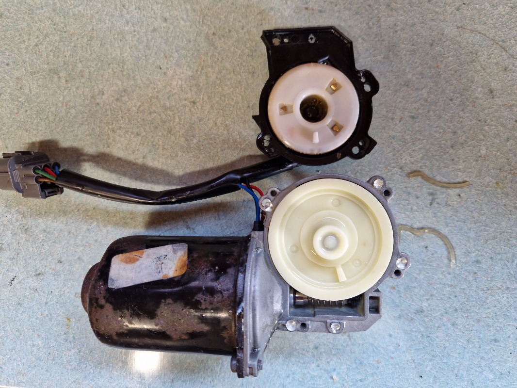

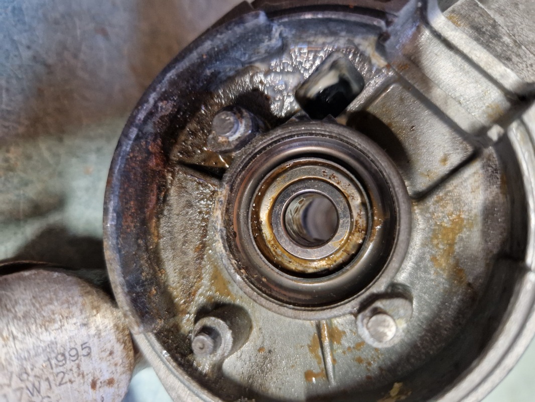

Well not quite. The motor arrived complete with a "repaired" linkage. I planned on using mine so I removed the motor and plugged it in.
SILENCE!
I had a look inside and it was clean as can be.
I did have a thought that my noise was caused by the oilite bush spinning in the circlip so I tried my cover on the new motor and it was silent. My cover was cleaner on the outside so I left it on.
I will strip it at my leisure cos I need to get to the bottom of it.
Right now the car is back on the road!
Last Edit:10 months 1 week ago by TA22GT
Last edit: 10 months 1 week ago by TA22GT.
  • TA22GT
  • Posts: 1969
  • Thanks: 486
Replied by TA22GT on topic Noisy wiper motor!
Posted 10 months 1 week ago #218948

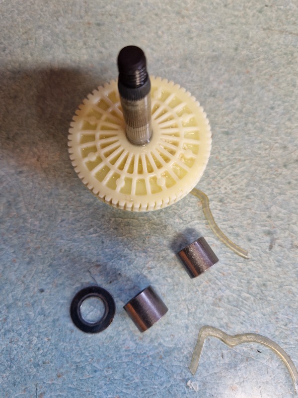

 Started stripping it down. When you drill out the rivets holding the gearbox to the body you have this.
The gear wheel and the drive shaft lift out. There is a washer between the gear and the housing. The shaft runs in two stacked oilite bearings
 I tapped them out using an 11mm quarter inch socket. They were perfect.

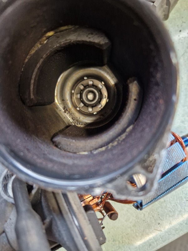

The armature spindle runs through the bearing in the centre of the body and there is a small circlip holding it in place. You can see it to the left of the worm drive.

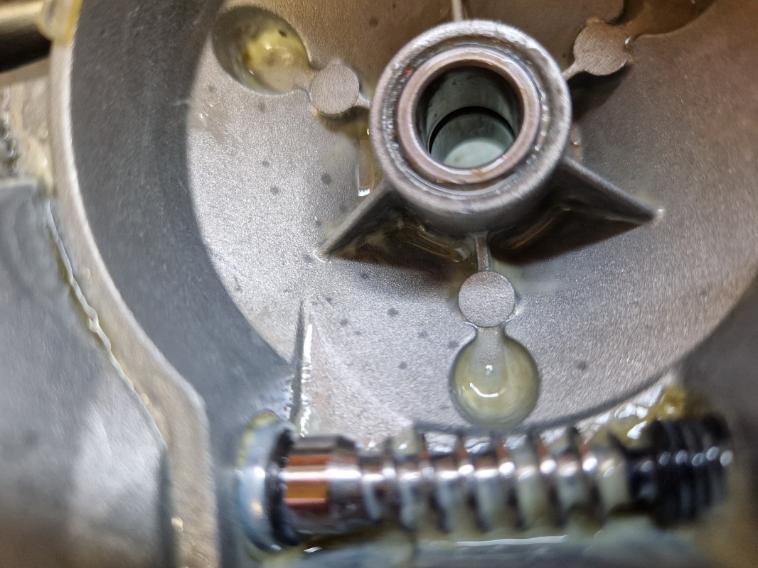

Next is the difficult part. The spindle has to be drifted out via the hole where the grub screw fits. Remove that so a bolt can be used to drift the spindle out. My punch wouldn't go through the hole.

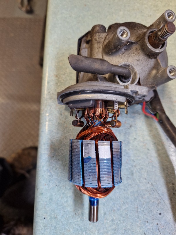

CAREFUL! You need a vice to hold the body firmly so you can drift out the spindle whilst trying to hold the bakelite/phenolite board secure so the brushes don't fly apart! It needs quite a whack.
As the shaft passes the bushes they pop out and the springs can fly out!!
You are left with the offending bearing and in my case a very rough sounding one too
That's as far as I have got. Just have to get it out and order another. There is a number on it so no need to pay silly prices.
