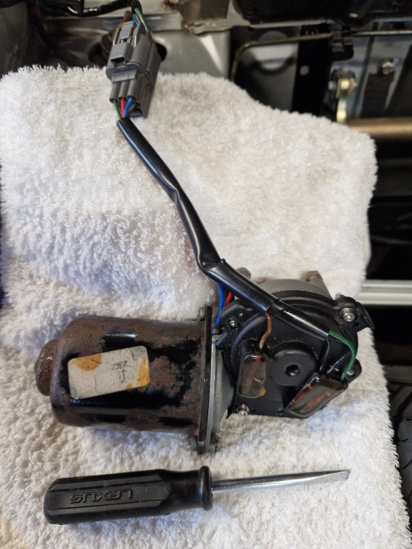

Noisy wiper motor!

Thanks for that advice AP.
I am not happy with the fit as I know it should be tight in the inner bearing. I can see this is very likely to dance.
If it does it will be easy to remove the circlip and pull the shaft back out and "glue" it in.
I am no engineer but I do know what I am seeing is not good.
It has become a "see it through to the end" project now!

Thank you.. will go measure the shaft just now.
I have been looking at the Loctite stuff that AP mentioned and it would do the trick.
The shaft is 8.02mm diameter.
The 608 2RS bearing is advertised as 22mm x 7mm depth with internal hole for the shaft as 8mm.
The diameter and depth are correct with the bearing I have but I can't measure the hole with my cheapish calipers.
I reckon a better quality bearing..say a SKF would be ok.
I've gone this far so one way or another I will see it through just for personal satisfaction and hopefully a spare motor!

Thanks!
I think I am going to go for the Loctite bearing fit. It's a slack fit but it's not ridiculous. I was just surprised that's all after having to drift the other one off.

Cheers Vince..good to know and as it is not under duress I think it will be ok.
I ordered some earlier tonight.

The Loctite bearing glue finally arrived and I put it all back together.
I now have a spare wiper motor should I need it.
It's not whisper quiet out in the open but under the bonnet and sat in the car it is fine.
If I had to do one again I wouldn't flinch as I did make extra work for myself as I did things that are unneccessary. I would also spend £2 extra to get a SKF bearing.
Don't be put off having to drill the rivets to get the gearbox cap off. Nuts and bolts hold it all back together with a little silicone underneath to keep it water tight.
The noise will almost certainly be the bearing so no need to remove the oilite bushes for the driveshaft.
Be careful with the bakelite plate holding the brushes and the wiring. It sits on two stantions that are rounded over to hold it in place. The third stansion is just a locating peg and has no hold on the plate. I used a very pointed modelling knife blade to prick around the stantion to free it then used a dab of Araldite to secure it when it was put back.
Fiddly jobs like this are not my forte but I wanted to have a go rather than throw it away and I'm glad I did.
